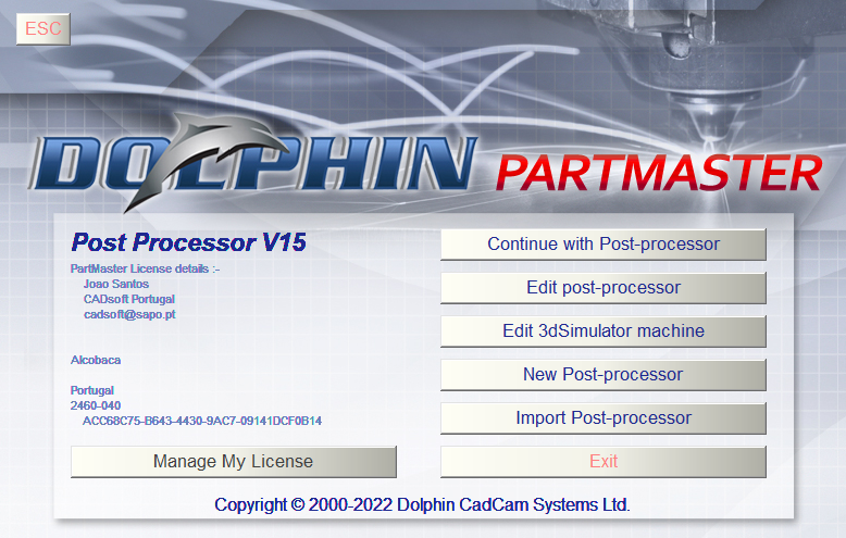

To do this click the PartMaster Post Processor icon from your desktop. You must run it being an Administrator.
After opening, choose the option Import Post-processor.
Browse to the folder where the modified post processor was saved and choose it. Confirm.

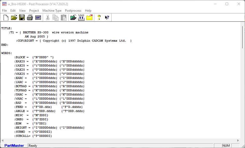

When the file has been imported you will see the contents in the display area, next, choose Compile from the top toolbar to create the .ppx file.
The new post-processor is now ready for use. Close the post-processor by using File > Exit. When you next run DCAM or DWES the post processor will appear in the drop-down list along with all original posts.
