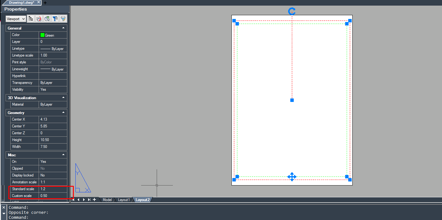

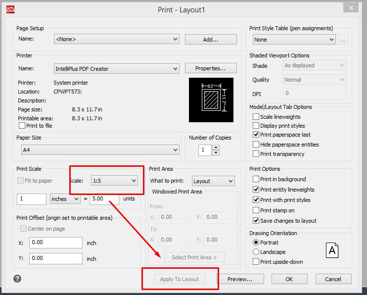

3) In layouts you have the option to create viewports, each of them displaying objects from a different scale. You can by selecting each viewport and arrange the scale from the property panel (p.1). To define the same scale in the layout the easiest way to achieve that is from the plot dialogue (p.2) You define the paper size and the scale and then select ''Apply to Layout''.
