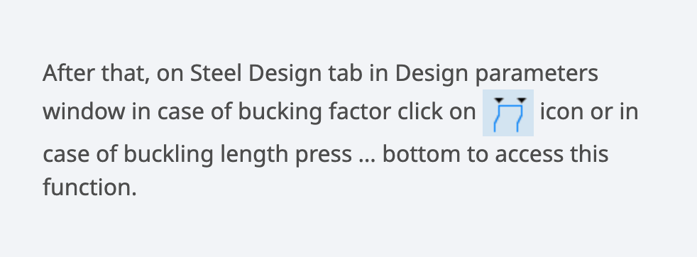

To use this function, it is necessary to have result of the Buckling analysis (Buckling tab). It is recommended to choose load cases and load combinations, that are relevant for the design member to get the critical cases.
