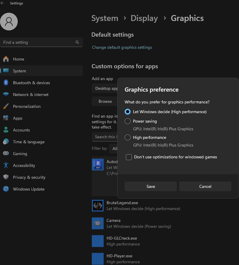

- If your system is equipped with both an integrated and a dedicated
graphics card, assign the dedicated card to the application for better
performance. To do this, follow these steps: Windows / System
settings / Graphics settings → Custom settings for applications / AxisVM /
Settings / Assign the dedicated graphics card.

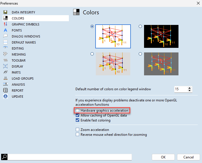

- If the issue persists, disable "Hardware graphics
acceleration" in the program settings by navigating to: Settings
/ Preferences / Colors and unchecking the “Hardware graphics
acceleration" option.
